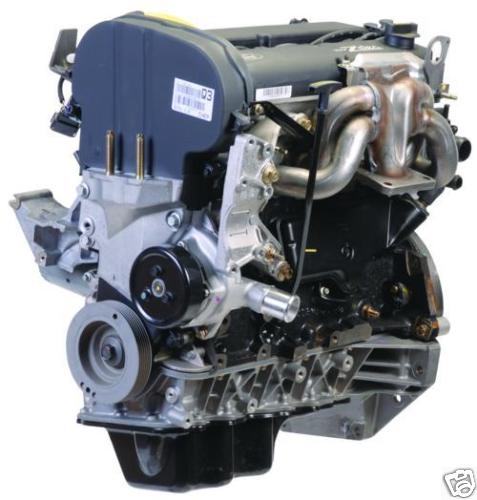

Хочу поставить новый Zetec 2.0L на Ford Focus USA ZTS 2001 года.
В чем отличие двигателей, которые приведены ниже от стандартного Zetec?
Есть такие предложения:
1)
BRAND NEW ENGINE ZERO MILES. FORD 2.0 LITER ZETEC DOHC ENGINE COMES
WITH OIL PAN. VALVE COVER. FRONT COVER. EXHAUST.
THIS ENGINE IS A DIRECT FACTORY REPLACEMENT FOR THE FORD FOCUS. 2000-2004. VIN "3". ("3" MUST MATCH THE 8TH DIGIT OF YOUR VIN NUMBER).
GREAT ENGINE USED IN VANAGON RETRO FIT. RACING AND OTHER SPECIAL PROJECT VEHICLES.
2)
Ford Racing Focus Zetec 2.0L Engine
New Ford Zetec 2.0L engine - M-6007-ZX3
Interchange Part Number: 3G-785-CA Manufacturer Part Number: M-6007-ZX3
2.0L (121 cu. in.) 4-cylinder DOHC
NEW Complete Engine, not remanufactured
130 hp @ 5,750 rpm
127 lb-ft of torque @ 4,250 rpm
9.6:1 compression ratio
Fits 2003 Focus ZX3 and ZX5. May fit other applications with minor modification.
Complete engine assembly throttle body to oil pan including exhaust manifold, flywheel, clutch, and engine injector harness
Does not include computer or other wiring
3)
M-6007-ZX3**
2.0L (121 cu. in.) 4 cylinder DOHC
130 HP @ 5,750 RPM
127 ft./lbs. of torque @ 4,250 RPM
Fits 2002 Focus ZX3 and ZX5. Complete engine assembly throttle body to oil pan including exhaust manifold, flywheel, and engine injector harness
Engine code 2G-779-BA, 3G-779-BA, 3G-785-AA, 3G-785-CA or current production
4)
Brand new engine for the Ford Focus. NOT REMANUFACTURED.
130 HP @ 5,750 RPM
Fits The Focus ZX3 and ZX5.
Complete engine assembly. Throttle body to oil pan including exhaust manifold, intake manifold, flywheel, clutch, preassure plate, spark plugs, coil-on plugs, engine injector harness, COMPLETE.
Does not include computer or other wiring (New harness may have to be purchased or the use of the old one)
BLOCK: RFYS4G6015AE
HEAD: RF-YS4E-6090-AD
FCSD P/N: 3S7Z-6007-DA
ENGINEERING P/N: 3G-785-CA
Engine code 2G-779-BA, 3G-779-BA or current production.
Approved for the NASA Spec Focus and the USAC Ford Focus Midget Series
Local pick ups are welcome at no additional fees. We also welcome your own freight arrangements and no extra charges.
SHIPPING QUOTE (WRITE WITH YOUR ADDRESS FOR A FREIGHT QUOTE) applies to the continental U.S.A. only; and address must be a business address (any business) due to weight and handling. We can ship to a non-business but rates are much, much higher (Engine is packed on pallet and ready to ship.)
Buy with confidence and reassurance, We are a Ford Racing Warehouse Dealer
DIMENSIONS: CRATED ENGINE 48H x 42L x 41W @ 400 pounds
Ford Racing P/N: M-6007-ZX3
Три последних по моему FORD RACING.
Ford Racing is the Ford Motor Company's racing division and the multinational name used for its motorsport activity.
У этих моторов какие то измененные характеристики?
Мне не совсем понятно и там и там Zetec
На ZTS и ZX3 или ZX5 двигатели отличаются?
И есть ли различие например между 2001 и 2002 годом выпуска?
Свой номер в микрокате пробить не получается почему то.
Какие тут могут быть подводные камни?

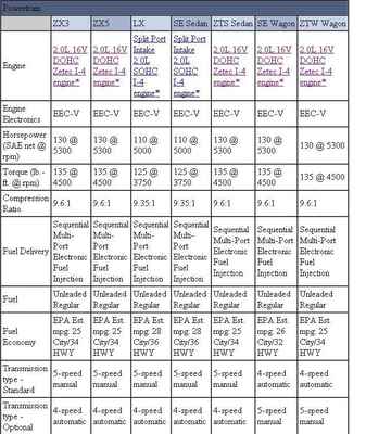

Вот в стандартной спецификации пишут обороты 5,300 rpm, а у тех что выше 5,750 rpm.
Как это будет воспринимать компьютер?

Engine Data - Zetec-E
2.0L DOHC 16V
Engine management-EEC V/SEFI
Emission standard-96 EEC Fuel-91 RON unleaded
Identification code-CAA
Firing order- 1-3-4-2
Bore (mm) 84.8
Stroke (mm) 88.0
Cubic capacity (cm (3)1.988
Compression ratio 9.6:1
Engine performance(HP) 130
Engine performance (rev/min) 5,300
Torque (lb ft) 130
Torque (rev/min)4,000
Idle speed (rev/min) 800
Speed limitation (rev/min) 7,100
Capacity
Description Litres
Engine oil, initial fill incl. filter 4.35
Engine oil, oil change incl. filter 4.25
Engine oil, oil change excl. filter 3.75
Dimensions
2.0L
Number of main bearings 5
Cylinder bore Ø, class 1. 84.800 - 84.810 mm
Cylinder bore Ø, class 2. 84.810 - 84.820 mm
Cylinder bore Ø, class 3. 84.820 - 84.830 mm
Inner Ø, main bearing shells (fitted) 58.011 - 58.038mm
Inner Ø, main bearing shells (fitted) (main bearing shells with stepped sizes)
58.008 - 58.031mm
Main bearing radial clearance 0.011 - 0.058mm
Main bearing radial clearance (main bearing shells with stepped sizes)
0.020 - 0.042mm
Main bearing parent bore 62.287 - 62.300mm
Dimensions
2.0L
Piston Ø, class 1. 84,770 - 84,780mm
Piston Ø, class 2. 84,780 - 84,790mm
Piston Ø, class 3. 84,790 - 84,800mm
Piston clearance in cylinder 0,010 - 0,030mm
Piston ring gaps (installed)
- upper compression ring 0,30 - 0,50mm
- lower compression ring 0,30 - 0,50mm
- oil scraper ring 0.40 - 1.40mm
Ring gap position: The piston ring gaps must be distributed evenly around the circumference of the piston This also applies to the oil scraper ring elements. Align the ring gaps at 120 degrees to each other.
Dimensions
Crankshaft
Main bearing journal Ø 57.980-58.000mm
Main bearing journal end float 0.09-0.26mm
Connecting rod bearing journal Ø 46.89-46.91mm
Dimensions
Lower crankcase
Required spacer washer thickness if there is a gap between the cylinder block and the lower crankcase of:
0.26 mm - 0.50 mm 0.25mm
0.51 mm - 0.75 mm 0.50mm
Dimensions
Connecting rod
Bore Ø, big end 49.89-49.91mm
Bore Ø, small end 19.951-19.981mm
Inner Ø, connecting rod bearing shells (fitted) 46.926-46.960mm
Connecting rod bearing clearance (radial) 0.016-0.070mm
Connecting rod bearing clearance (axial) 0.090-0.320mm
Dimensions
Piston pin
Piston pin length 55.80-56.20mm
Piston pin Ø, white 19.997-20.000mm
Piston pin Ø, red 20.625-20.628mm
Piston pin clearance in piston 0.016-0.049mm
Dimensions
Camshaft
Number of camshaft bearings 5
Drive Drive belt
Bearing journal Ø 25.960-25.980mm
Camshaft bearing radial clearance 0.020-0.070mm
Camshaft end float 0.080-0.220mm
Dimensions
Valves
Valve clearance in the valve guide
Intake valve 0.017-0.064mm
Exhaust valve 0.017-0.064mm
Intake valve clearance (at 20øC ñ 5øC) 0.11-0.18mm
Exhaust valve clearance (at 20øC ñ 5øC) 0.27-0.34mm
Dimensions
Cylinder head
Maximum distortion (mating surface) 0.1mm
Height of mating surface 2.0 +0.12 -0.24mm
Oil pressure at 800 - 850 (rev/min) 1.3-2.5bar
Oil pressure at 4000 (rev/min) 3.7-5.5bar
In the 2,0L engine, the piston cooling nozzles are fully open at 4000 (rev/min). This results in a pressure loss of 0.3 - 0.8 bar, meaning that the 2,0L engine can be in the lower pressure range.

Нужна замена двигателя на первом фокусе. Вопрос такой- подойдут ли к нему двгатели от второго фокуса? Меняется двигатель+коробка+полуоси. Осуществимо ли без критических переделок?
Просто б/у движок/коробку от первого фокуса в нормальном состоянии не найти уже. Осуществимо ли без критических переделок? Или дешевле новый автомобиль купить?
Vovan_mail
31 March 2011
andrey_x128
Плюс проводка, плюс мозги , плюс вся электрика от второго фокуса. Я себе из сплит порта переделывал на зетек и то хлопотно.

Уважаемые, прошу помощи в решении вопроса о приобретении двигателя.
Имею: ff1 2003 года, 2 литра, eddb.
Требуется: замена двигателя.
Нашлось предложение в городе неподалеку на двигатель с японского фокуса, продавец утверждает, что продал уже не один такой и проблем якобы не было, к европейцу подходит. В то же время, ремонтеры, которые ездили смотрели двигатель утверждают, что он "маленько не такой".
Вопрос: если кто-то сталкивался с двигателями из японии, подходят они к леворукому фокусу отечественной сборки?
Машина стоит в ремонте 3-й месяц, двигатель найти не могут, ищу теперь сам.
Oleg_KRSK
21 April 2011
ElecTrick
Если там стоит Zetec-E, как и у вас, то все должно подойти, в любом случае навесное вы можете и своё оставить.
ElecTrick
21 April 2011
вот ссылка на фотки двигателя, кто знает - подскажите оно или нет) если это возможно сделать по фото конечно
